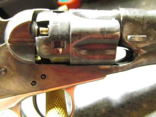

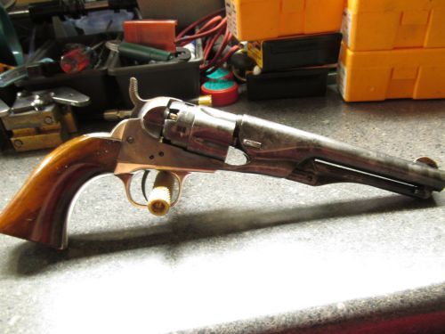

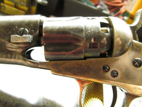

well just wanted to post my fiasco with my 2nd gen colt. my what a disappointment this little pistol has been. for all its problems and trials ... this is one of the funnest pistols i own to shoot and mess with.
-very first thing was the nipples from a brand new pistol ... had to be replaced.
-second thing after getting good nipples was to have to shave the hammer where it was contacting the frame and not getting the protrusion it needed.
- third thing that I did wrong with it was trying the ultrasonic cleaner ... pictures show what happened to the pristine bluing.
-forth thing was the trigger and bolt spring breaking and needing to be replaced.
- now i see that the cylinder stud is too short by nearly 1/8th inch witch i will need to work on here directly.
- the other thing is that the frame is not clearanced enough to allow the busted caps to escape when cocked for the next shot ... equalling jams and hard times installing the caps in the first place.
the stupid thing just continues to give me experience after experience ... at least it cost a lot ... LOL.
this is the absolute funnest shooting pistol tho ... for all the tribulations i have gone thru it be cool in the grandest. so that is my sordid tale and now ... with no further adieu ... here she be !
so there she be. a fun shooter but my ... what a road we have been down. photo's leave a bit to be desired but it be the best i know how to do.

that finish nearly made me throw up i will have to say. i put it in the ultrasonic to ensure it got clean and also to try it out and MAN ... i pulled it out and shoved it under hot water to rinse her off for what i thought was just gunk and it all stayed on there. took a soft towel and began to wipe it and still held this mottled old timey  look. i couldnt believe my eyes as i looked at my precious Colt ... but soon i got used to it and i gotta say that what with all the stuff i had to do to make her run ... this finish allowed me to dig rite in and take the bull by the horns.
all in all ... even with all the drama ... this lil colt is a hoot to shoot and that penny on the front gets those balls rite on target when i do my part. think when the dust settles i will try another in a different barrel length but this time it will be Pietta or Uberti ... HA !!!

I had the 'soap' that came with the hornaday ultrasonic cleaner. I had shot the little Colt and it were pretty filthy so there was a bunch of BP fouling on and in it. it didn't take but about 15 minutes to provide that finish. I like it better each time I look at it but ... when it happened it made me sick to my stomach.
it were a HAPPY accident for sure as I find myself reluctant to do anything about it. I ... like most others ... like it better then any other finish that coulda come on it ... now!!

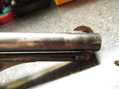

How did you solder that penny on?

the penny is soldered on with soft silver solder and a propane torch. the next penny I did came out a lot better tho as I took my small dremel and a small cut off wheel and put a slot in the barrel where the penny would slip in the slot for more sturdy position before soldering ... then I positioned the torch on the inside of the barrel mostly with a little flame going on the front of the penny ... next after it got hot enough to melt the soft silver solder and having fluxed it before hand ... I dabbed the solder on the crack where the penny is down in the slot I carved and continued to dab the solder till the slot/crack filled with solder ... then I allow it to cool completely before I even touched it. after the solder job I took a jewelers file with a very pointed tip and worked carefully around the penny to make it all look the same. then after a good cleaning I took some cold blue from Birchwood Casey and touched it up where there were shiny metal showing ... walla ... even this one armed turkey can do it ... im sure you would have no problem ... just go slow and think everything out completely before putting action to thought.
