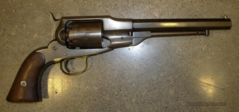

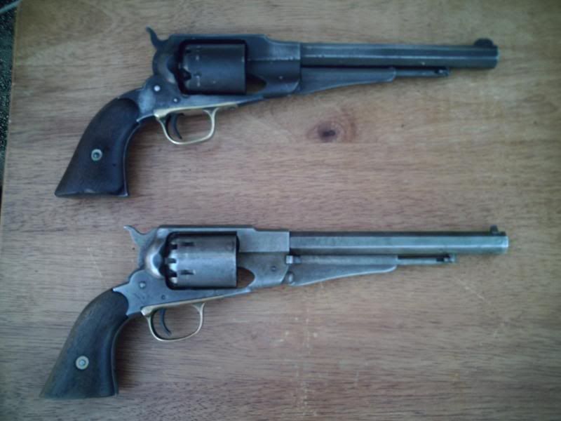

The 1858 Beals Army(Circa 1858) had a barrel twist in the direction that would unscrew the barrel that's one thing that was changed on them so the opposite twist was on the 1861 Old Army Rems (Circa 1861-1862) and also on the 1858 NMA Rems (Circa 1863 0n) for the Army to accept them for purchase among other changes...
SG
Beals 1858 Patent Sept. 14, 1858
My 1861 Old Army Model, Circa1862
My 1861 Old Army Remington(Top) and U.S. Marked 1858 NMA ASP(Armi San Paolo)(Bottom)
"Ol Rusty" my 1858 NMA U.S. ASP Rem & a NIB 1858 NMA Euroarms in SS...
