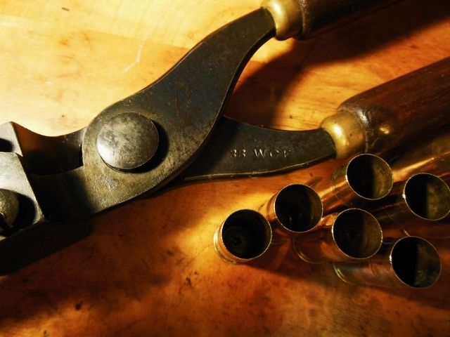

I have all of the components laid on the bench. The hulls were previously de-primed and cleaned. All but three have already been re-primed. You will notice two types of wads in the upper right side. One is a thick fiber wad that I use for filler and shot cushion and the other is a hard type that I use to keep the shot contained in the brass hull.

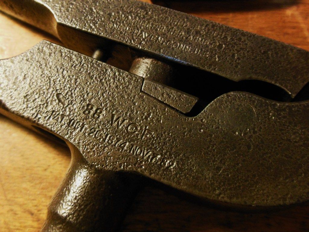

Here is an original priming tool that I use. It is of the simple tong type construction.
I flip it open, insert a hull into the recess, and place a new primer on the pocket.
Then with a bit of finess, I cam the opposite handle over until the primer seating stud make contact with the new primer and then squeeze it into place.

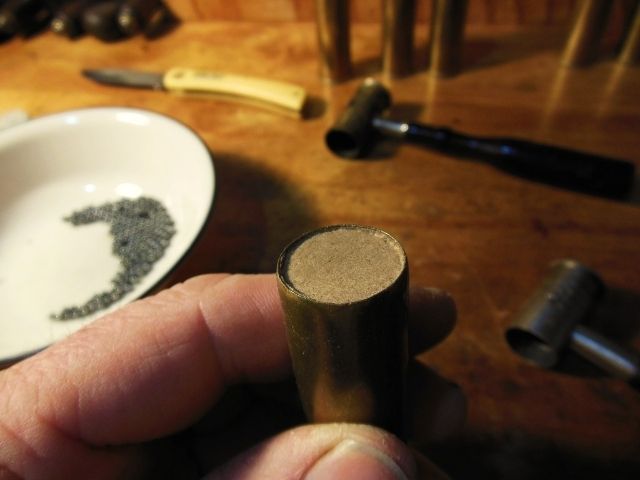

Now there is a gap in the procedure that I did not include with pics, but after dumping the powder charge in the case, I stuffed two of the thick fiber wads directly on top of the powder and seated them with a dowel. I then dumped the charge of shot on top of the wads. I had already figured out the wad column height that I needed. All I need to do now is insert an overshot wad.
Now mind you, this press and die is a brand new addition. For years, I have been gluing the over shot wad in place. However, I wanted to see how well a roll crimp would work, so I am giving this new step a try. The die is also supposed to re-size the hulls, but for that purpose, the die has proved to be as useless at tits on a turtle. But is does indead put a nice roll crimp on the mouth of the hull to hold the over shot card in place.
And there you have it. I pressed the over shot wad into the case mouth and then ran the hull up into the die to apply a roll crimp that will serve to keep the wad in place. I now have a black powder hand loaded brass shotgun round ready to go. I intend to take a wild turkey with one of these freshly loaded rounds in a few weeks. I will shoot a few of them in a day or so and do up a post about the shotgun that I am using them in.
