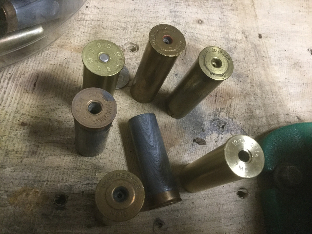

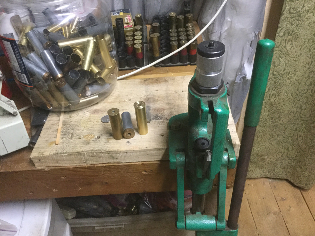

i loved the write up Dave.... i do most of what you do with a couple exceptions... i have a complete rockchucker press setup with the RCBS 12g die set. it works great for putting a tiny bit of a roll crimp on the end of the shell. helps hold the shells together. i have found some in my pocket a time of 2 when walking around through the brush where the glue alone did not hold... its a drag when you reach in your coat pocket to grab a shell and have a handfull of components and shot...lol. i dont use the rock chucker for decapping or anything else but the roll crimp. i also aneal the ends of the shells occasionally to keep them flexable... i just dip them in my lead pot when casting till they start to change color, pull them and give a tap.. let them cool..
as far as the components go, I did spend the 100 bucks to get a set of shells from Rocky Mountain Cart Co that were thicker and could use the standard components, and they work great with one exception.... they dont roll crimp, so if you have a glue failure your out of luck.
here is what my setup looks like...
and some of the different headstamps I use...
I really like the alcan zinc shells the best as they take a roll crimp nicely, dont have to be annealed, and are native 209 primer fed with no drilling...
